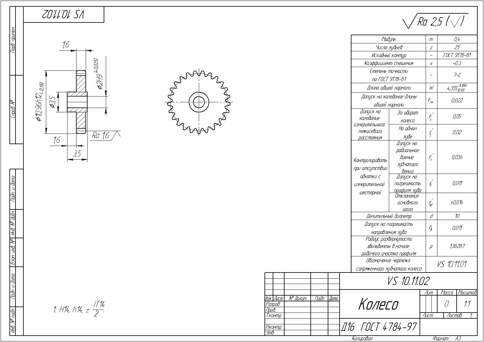

Повідомлення leo_run » Суб листопада 19, 2011 12:20 pm
зная что деталька больная на голову нашел на Белорусском форуме
прменяется на
Volvo Saturn Nissan Jeep Dodge Odometer Gear 25 Tooth - NEW
This is a Brand New 25 tooth odometer replacement gear for Volvo 200 series , Nissan Puslar, Pintara , Sentra , and Saturn vehicles. Also fits Jeep Eagle , Dodge Monaco Models.
This is a gear that fits into the odometer assembly.
The gear diameter is 10.5mm. Center hole is 2mm diameter. Overall height is 3.5mm. Gear thickness is 1.5mm.
If your broken odometer gear is close to these dimensions and has 25 gear teeth on it, then this is the gear you will need.
High speed precision machined gear. (Not molded)
Made from high grade delrin plastic. (Toughest plastic available)
Better than original OEM part. This gear will not break.
Fits other auto manufactures and models.
If you have any questions, please email me prior to bidding.
